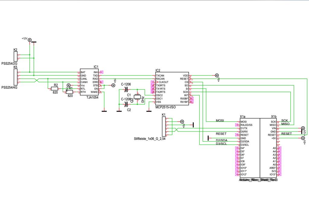

I am using this circuit schematic found here: http://www.volcano.at/iDrive/?p=516
Название: Screenshot 2018-07-31 at 13.39.04.jpg
It uses a TJA1055 + MCP2515
I did NOT use an Arduino Micro though - instead I used Adafruit Feather Bluefruit 32u4 as it has built in BLE and is HID capable. (https://learn.adafruit.com/adafruit-...it-le/overview)

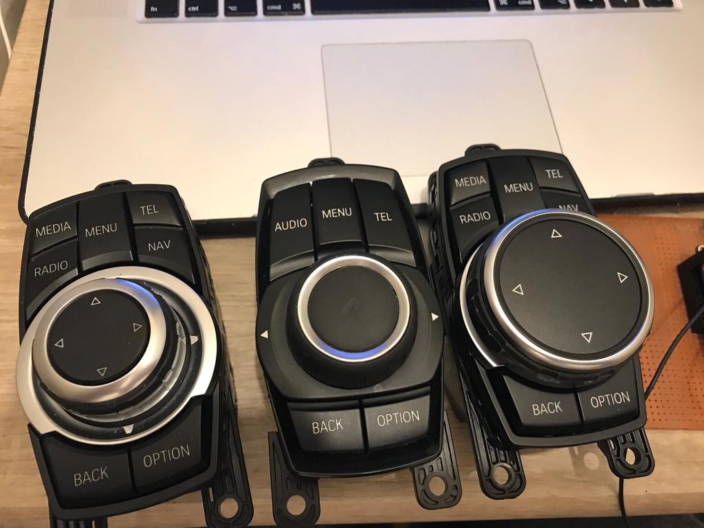

It almost works perfectly on the 7 button touch controller on the right, but I am having a minor problem and hoping someone may be able to help. The touch controller isn't always responsive - it's as if there's a timeout happening (and not to do with the wake command)
All buttons work, but sometimes there is a delay. Touch and rotation is also working but sometimes a delay.
I get these can-bus responses when there's a problem:

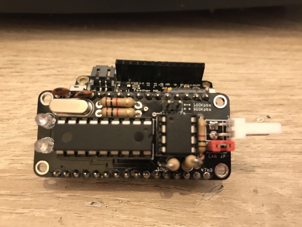

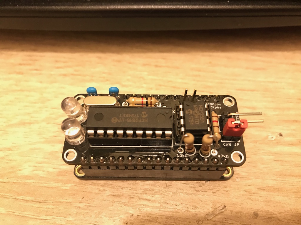

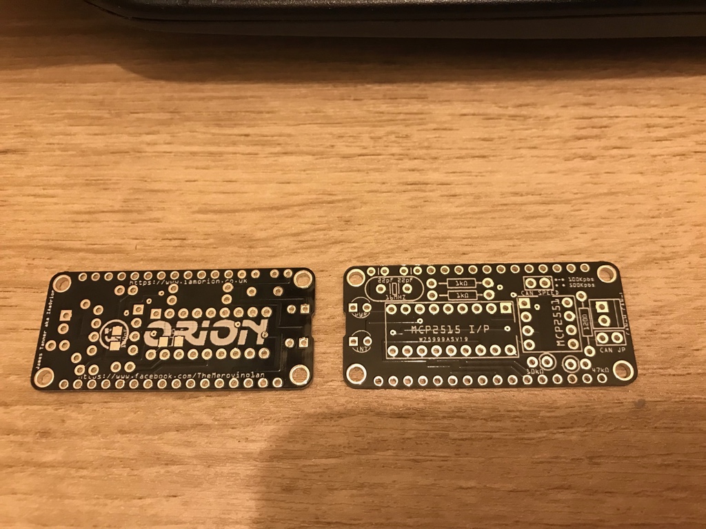

I've actually come on along way since I first posted this... I now have a completed feather can-bus shield.
I designed it as a "feather" shield so that it would fit Adafruit's Feather boards.
I also made it to use THT (Through Hole components) so that the it was pretty easy to solder even for novices
My code works on either of these boards.
The Feather M0 BLE: https://www.adafruit.com/product/2995
Or the Feather 32u4 BLE: https://www.adafruit.com/product/2829
I chose to use The Feather M0 BLE: https://www.adafruit.com/product/2995 because it has much more free memory and program space.
My can-bus shield sits on top of it like the pictures below. My code is written in the Arduino IDE
