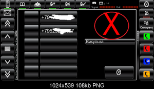

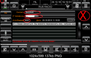

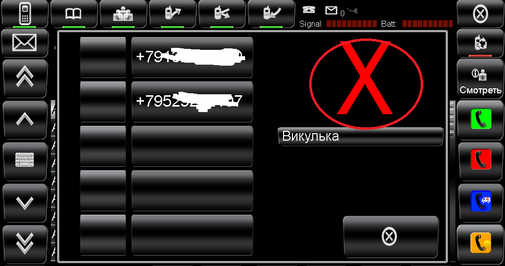

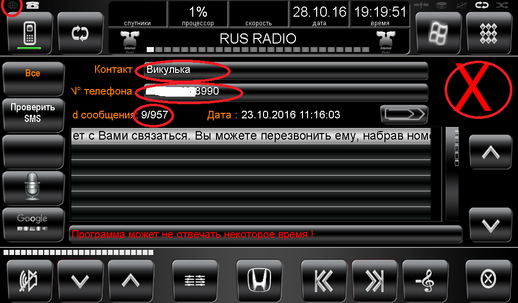

also not shown photo, although in the phone book is displayed normally. Not properly displays Internet connection status.
If you open the "Favorites" tab with multiple subscriber numbers also lost picture. In the phone book, caller photo is displayed normally.
Call history not correct.

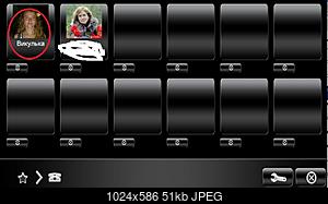

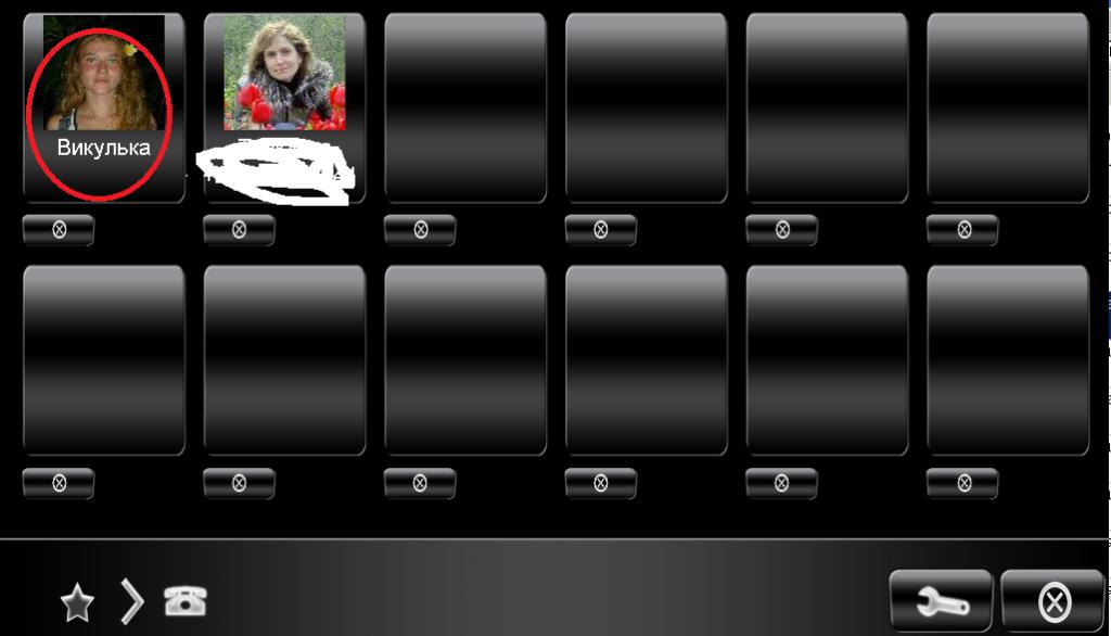

I have found an error with the favorite 5 et 6 that had the same picture !
Into your skin.ini, do you have MOBILEPHONE_FAVORITExxx lines if yes can you send your skin.ini ?

1. also not shown photo, although in the phone book is displayed normally.
2. Not properly displays Internet connection status.
http://pccar.ru/attachment.php?attachmentid=45321

1. If you open the "Favorites" tab with multiple subscriber numbers also lost picture. In the phone book, caller photo is displayed normally.

replaced I,8,2,32,16,"!ONLINE"
to I,8,2,32,16,"ONLINE" in cf_ind_sms.txt
Now displays Internet connection status correct
