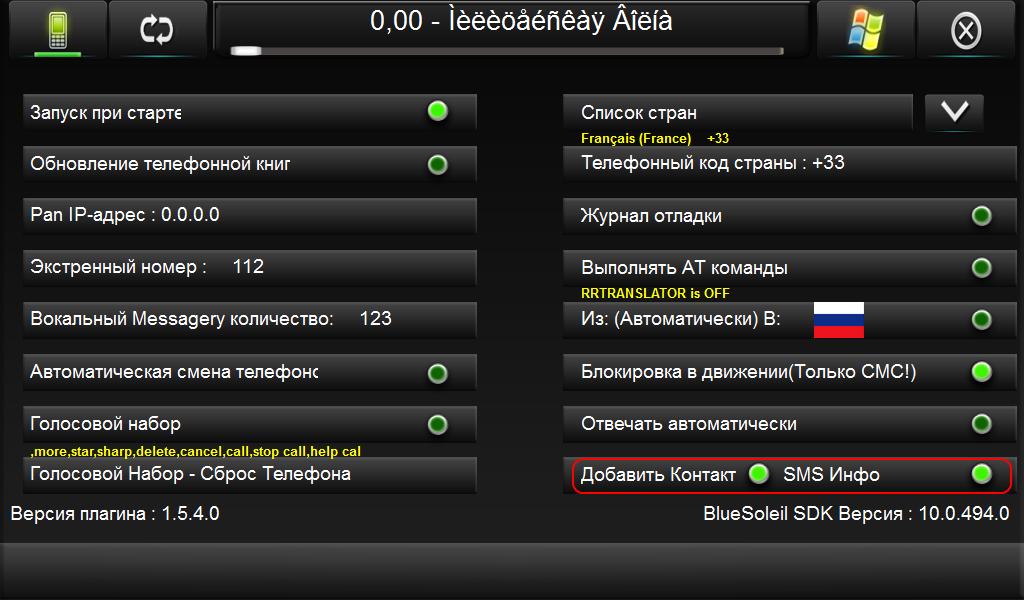

Машина: Nissan Qashqai+2
Сообщений: 3,424
About the popup , check your xml file <PhoneNoAddContact>false</PhoneNoAddContact> and set to true .
If, in MobilePhone Plugin I dial 466 & put handset
- then dial through a mobile phone : example 112, then (in popup) prompts save
466 again (but should 112).
<PhoneNoAddContact>true</PhoneNoAddContact> - does not help
Старый 13.08.2016, 12:57   #110
pierrotm777
Аватар для pierrotm777
Регистрация: 07.11.2010
Сообщений: 324
I have added the 'No Add Contact' and 'No Sms Popup' into the second setting's screen !
