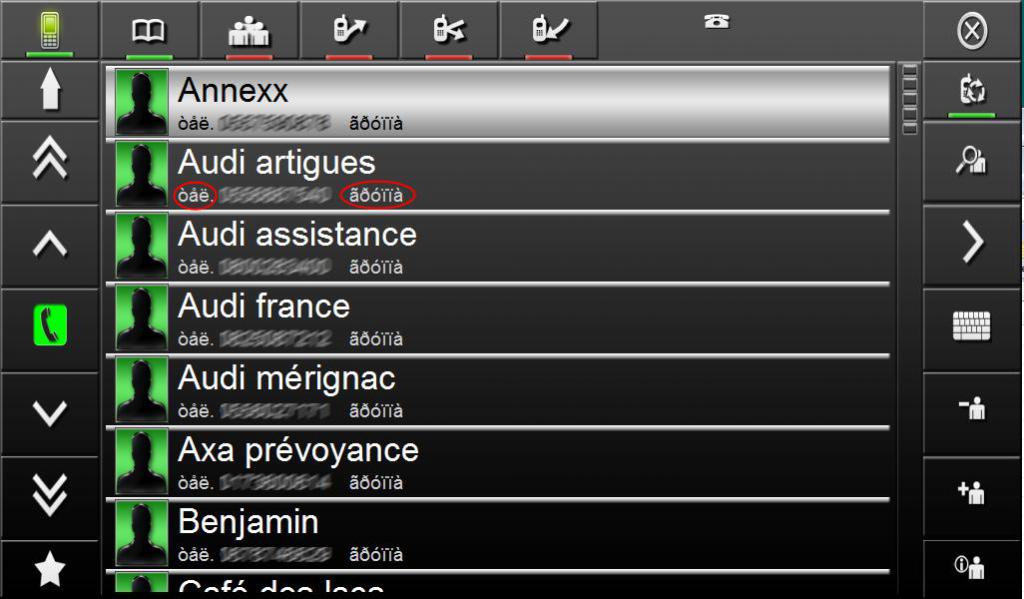

The original phone plugin return not unicode text when i use the language french on my pc .
Is it possible to have this text in my language when i select french please ?
