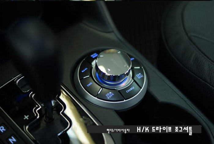

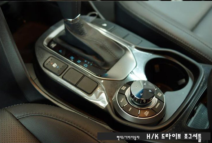

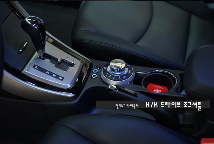

Может кому-нибудь доводилось сталкиваться с таким чудом корейской мысли? Называют его HK Drive. Не понятно как эта штука взаимодействует с головным устройством и универсальна она или заточена только ГУ для Hyundai/KIA.

Yuricat Он работает как ик-пульт. Настраивается с помощью стокового ик-пульта магнитоллы.
UNIVERSAL REMOTE CONTROL
H/K remote control model is factory preset for most popular navigation systems sold in the market
How it works:
Pull out the big round know upward to take the knob out from remote control body
Then you can see 2 LEDs on PCB top of PCB board, left one is indicator LED (Signal Indicator LED) and the right one is IR Sensor
Connection:
2 black wires = GND
Red wire = +12V ACC
Blue wire = +12V illumination
How to set buttons:
As all major brand products are factory preset for the most usual use, so no need to adjust all buttons, but at the same time, all buttons can be set by user to his preferred functions as follows
Remove the big round knob by pulling up.
Press Menu and ESC button for 5 seconds, together.
Then Red signal LED on right side will flicker (turn on and off) slowly
Press the button you want to adjust the function (for example, if you want the Menu button for some other function of change the fixed function )
Then the Red signal LED will be turn-off
Then press the function button on original remote control, orienting the original remote control unit to the input sensor of remote-control H/K
Once the process is done, the Red signal LED will flicker slowly again.
Caution: If the adjusting process is incomplete, then the Red Signal LED will flicker fast, then go to process 4, and check the Red signal LED turn off, and restart to adjust from process 4
Repeat process 4 to 7 to set all buttons
Once all buttoned are adjusted, leave the unit until the Red Signal LED turns-off.
