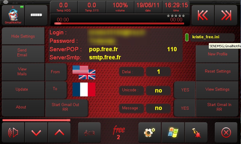

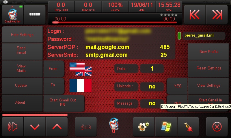

Smile Gmail Notifier for iCarDs and Emailer

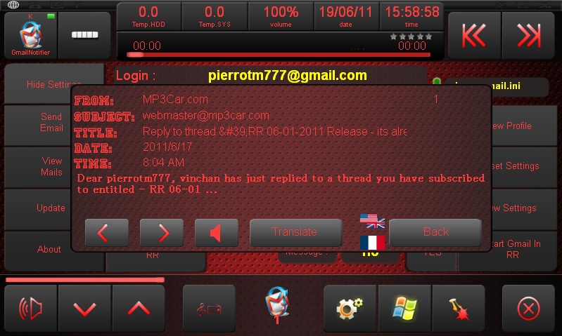

This plugin is a Gmail Notifier: :-)
You can read just the begin of each unread mail.
You can listen to you email.
You can to traduce your mail into the language that you want (you must to have my translator plugin )
PLEASE, read the readme.txt file for installation !

2-Add to your skin.ini file:
gmailpath=C:\Gmail\
and
APP1_NAME=GmailNotifier
APP1_PATH=$skinpath$Scripts\GmailNotifier\pop_tray.exe
APP1_WINDOW_TITLE=GmailNotifier
APP1_PARAM=
APP1_SCRIPT=SENDMSG;GmailNotifier;GMAILSETTINGS
APP1_SCRIPT_PARAM=
APP1_LOAD=1
APP1_OVERLAY=0
APP1_SKIN=gmailinit
3-Copy the MenuIcons folder into your THEME
4-GmailNotifier can give you the number unread message for a pop mail or gmail or hotmail.
You can send a mail for a pop mail or gmail or hotmail.
For Gmail , you can also read your email.

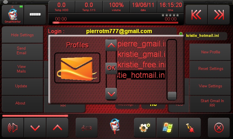

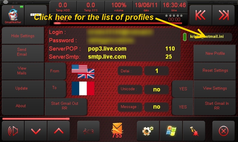

With this new version, you can now create one new profile , list your profiles and choose a profile into the list.
For launch the list , just click on the ***_***.ini or use the SENDMSG;GmailNotifier;GMAILPROFILE command .
I hope that you will like this new version !

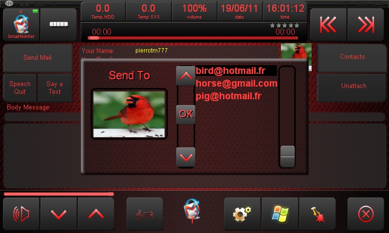

v0.9.8 20/6/2011
Little update. Now, on the 'Send email' screen, you can change the 'Mail To:' address by clicking on or by the contact list!
