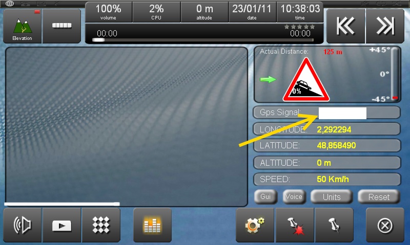

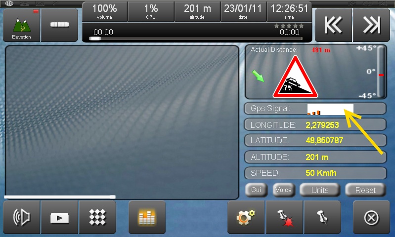

Red face Slider issue
I have an issue with my sliders
This is my code:
Код:
Y01,"SignalSliderImages\slider_*.gif"
S01,797,263,120,29,797,263,120,29,H,01," ",015,"GPSSIGNAL","Gps Signal"
S,981,121,13,122,981,121,13,122,V,,"SlopeSliderImages\cursor.png",5,"$SLOPESLIDER$",
As you can see my sliders are always down
and with this code , the gpssignal is always full(see the second picture):
Код:
Y03,"SignalSliderImages\slider_*.gif"
S01,797,263,120,29,797,263,120,29,H,03," ",015,"GPSSIGNAL","Gps Signal"

Сообщение от pierrotm777 Посмотреть сообщение
This is my code:
Код:
Is glad to hear you again
S,981,121,13,122,981,121,13,122,V,,"SlopeSliderIma ges\cursor.png",5,"$SLOPESLIDER$", - this command is not accessible in iCar
About Foobar write to private messages
[QUOTE = Bersenev; 169690] est heureux de vous entendre à nouveau
S, 981,121,13,122,981,121,13,122, V,, "SlopeSliderImages \ cursor.png", 5 ",$SLOPESLIDER$", - cette commande n'est pas accessible dans iCar[/ QUOTE]
If i understand well i can't create a var into an autoit script and use it as a slider ?
If a made a plugin dll , that can run ?
The answer in private message

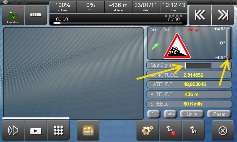

Smile
I have found a solution.
I have made a little dll for my slopeslider and for the gpssignal.
This is my code:
PHP код:
Public Function ReturnSlider(SLD As String) As Long
'This tells RR that the Slider was not processed in this plugin
    ReturnSlider = -1
    Select Case LCase(SLD)
        Case "slopeslider"
            ReturnSlider = RRSDK.GetInfo("=$SLOPESLIDER$")
        Case "gpssig"
            If RRSDK.GetInfo("GPSSAT") = 0 Then
                ReturnSlider = 0
            ElseIf RRSDK.GetInfo("GPSSAT") > 0 & RRSDK.GetInfo("GPSSAT") < 5 Then
                ReturnSlider = 15000
            ElseIf RRSDK.GetInfo("GPSSAT") > 6 & RRSDK.GetInfo("GPSSAT") < 10 Then
                ReturnSlider = 30000
            ElseIf RRSDK.GetInfo("GPSSAT") > 11 & RRSDK.GetInfo("GPSSAT") < 15 Then
                ReturnSlider = 45000
            ElseIf RRSDK.GetInfo("GPSSAT") > 16 & RRSDK.GetInfo("GPSSAT") < 20 Then
                ReturnSlider = 65536
            End If
    End Select
End Function
Now that run very well

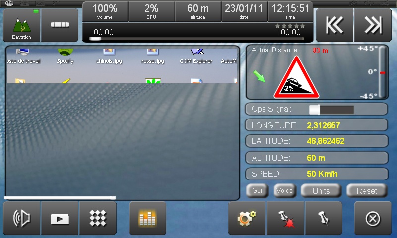

Another question around the sliders.
I want to change my slider*.gif files.
So , my new code is:
S01,797,263,120,29,797,263,120,29,H,03," ",015,"GPSSIG","Gps Signal"
That give me a slider with a white background.
How can i change that please .
Use png files instead of gif
