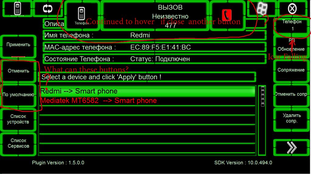

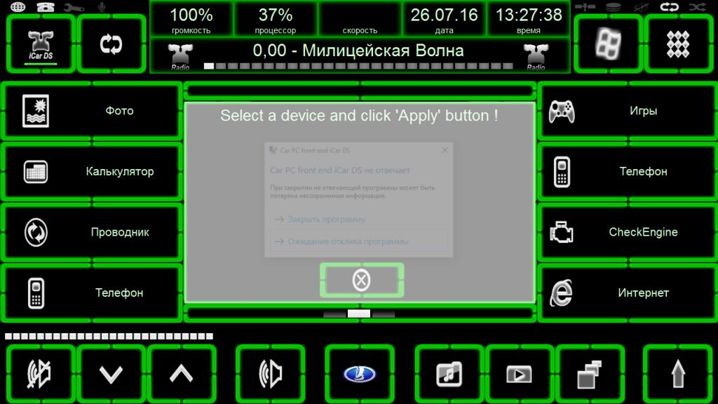

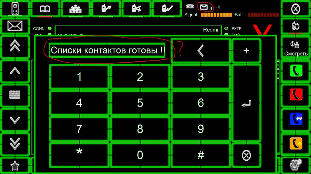

Why Prefix box? and how to change the country on your own?

should like is that Lexx09 add these add ons into the last icards version !
Said added after the stable version
Старый 27.07.2016, 16:40   #57
pierrotm777
Аватар для pierrotm777
Регистрация: 07.11.2010
Сообщений: 324
Smile
1 indicator looks for SMS endlessly and constantly blinking.
If the sms number is different to 0, the indicator is blinking always.
Read your sms with your phone , you will see that the indicator blinking is stopped and number return 0.
2 Keypad search (by first letter) does not work! Please remove it and make basic by clicking - a second keyboard (hold).
I want to keep a little keyboard for this feature (click button) but i need help for build this screen. Latin keyboard is ok but not the russian and i don't know why! May be a guy of the forum can help us ?
3 All messages are recorded in dialer string - and it is not convenient then removed (screen №2)
I don't understand why this issue ! I have not this problem why the RR version.
4 Closing the "information window" (1-t screen) often leads either to freeze or to IcarDS fall.
Do you use the log file ? If yes set log file in settings to 'false'.
5 Why can not you just dial the number - why should I enter?
Can you explain please ?
6 New window continues to hang from the top, if you close the other button. I think - this window do not need (screen №3)
It's an Overlay option that we can stop ! Just stop the idle option into the mobilcall.skin screen that call this window !
The prefix list help just the user when he want call an international number !
Into the second setting's screen, click on the second right line and change with your country code.
You can also change it with a text editor (replace 33 by your code).
The two buttons under the 'Apply' (save button) are needed.
One stop any change and the second, save a default xml file!
I have the idea to have just one SMS notification after the icarDS start and only other one notification each time we receive a new sms !
PS. The last version 1.5.1 solve the iPhone issue with the sms that we can no read !

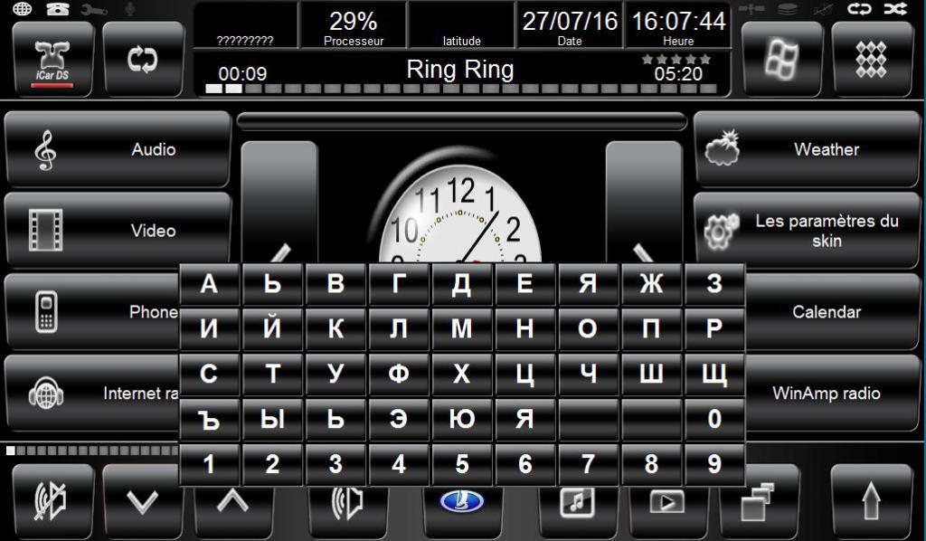

Can you test this new keyboard !
I think that all your letters are in this version !
By default, the variable KBLAYOUT is set to 0 for your country !
SETVAR;KBLAYOUT;0

Into the MOBILPHONE.skin screen, edit the button search with:
B,512,540,100,84,"MENU;SKIPTO_OSK.skin||SETVAR;KBLAYOUT;1",@OSKTOCMD;SEARCHNAME;SEARCHLIST;$SEARCHNAME$ @

also 2 th character
2 th character it should be " Б " , but not " Ь "
7 th character it should be " Ё " , but not " Я "
Gadina вне форума   Ответить с цитированием
