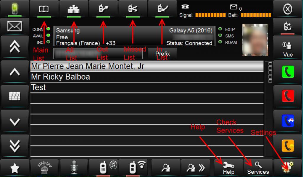

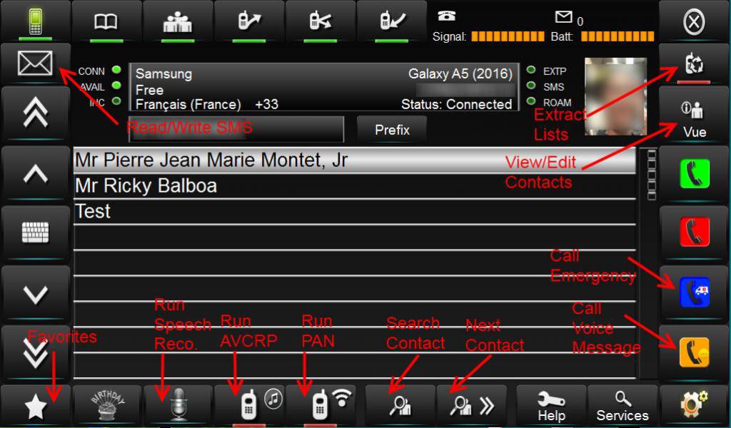

Can you try this last screen please ?
ID:	44292   Нажмите на изображение для увеличения

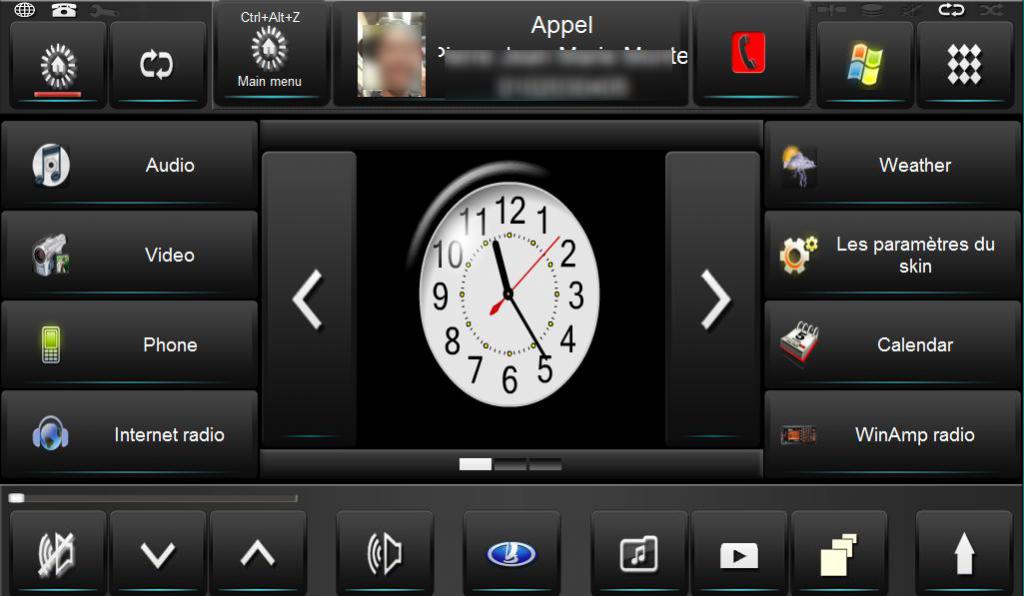

Can you try these other modified mobilecall screen ?
After 10 secondes, the mobilecall is exited and an overlay replace it !
I suppose than an overlay stay always on top if we change to another screen, but actually, it is exited !
If you have an idea how to do ?
