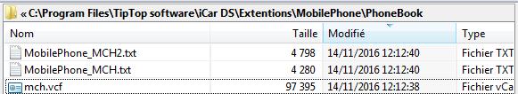

Look at that:

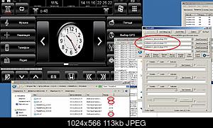

Старый 14.11.2016, 15:26   #393
Winlin
Регистрация: 19.11.2009
Сообщений: 308
Winlin is on a distinguished road
the contents of the files MCH.vcf AND MobilePhone_MCH.txt phone book , but not the list of missed calls

Сообщение от Winlin Посмотреть сообщение
You will find these files into the PhoneBook directory !
For reload these files, you must to use the command:
Код:
CLCLEAR;ALL||CLLOAD;C:\Program Files\TipTop software\iCar DS\Extentions\MobilePhone\PhoneBook\MobilePhone_MCH.txt

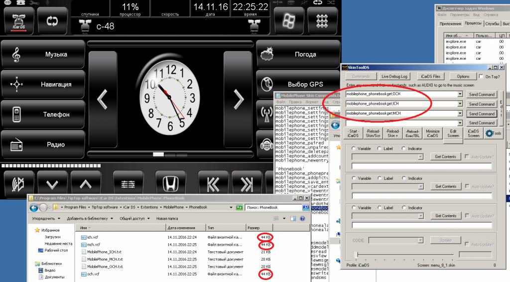

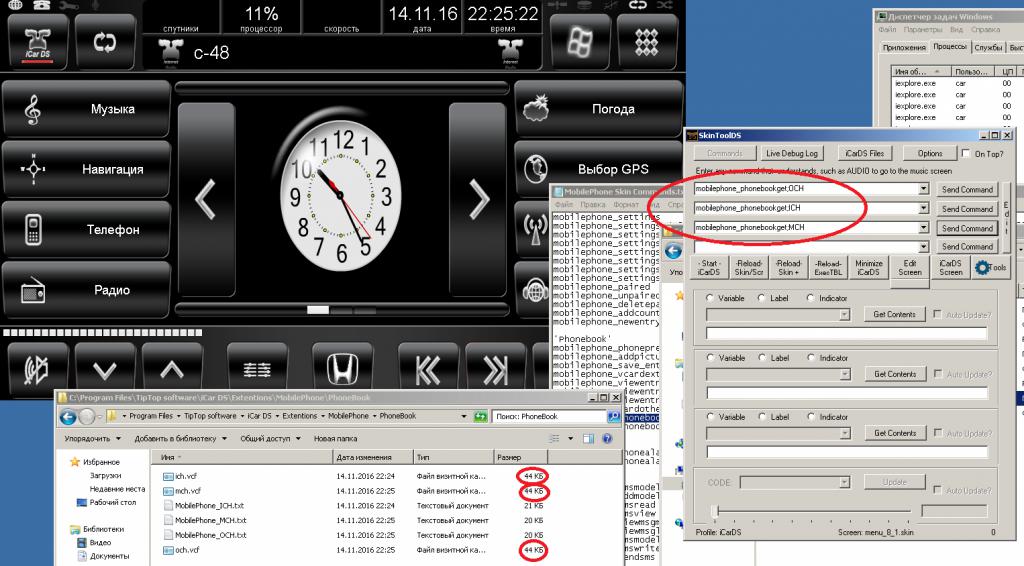

Сообщение от pierrotm777 Посмотреть сообщение
What do you want ! I don't understand , sorry !
I want to take it from a phone list of missed calls
but
When you run the command mobilephone_phonebookget;XX only changes the name of the files and the contents of the always phonebook
