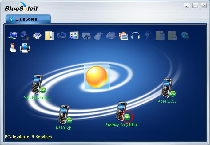

All happened at the second attempt
But I suggest simplify installation) :
Please note - The text climbs out beyond buttons (full screen)
Firstly, did you have installed Bluesoleil and paired your phone !
If yes, you need to setup the plugin only !
Ok,
It's better !
Then, click on the 4 th left button (that create a list of the phones paired)
If you have no list, Go to Bluesoleil software and paire your phone !!!!
See the picture:
Red cercle say that the phone is paired!
The name will be added to the xml setting file automagically by the plugin !
I have added 2 video in the first post and a zip file for a manual installation !!!!
