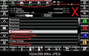

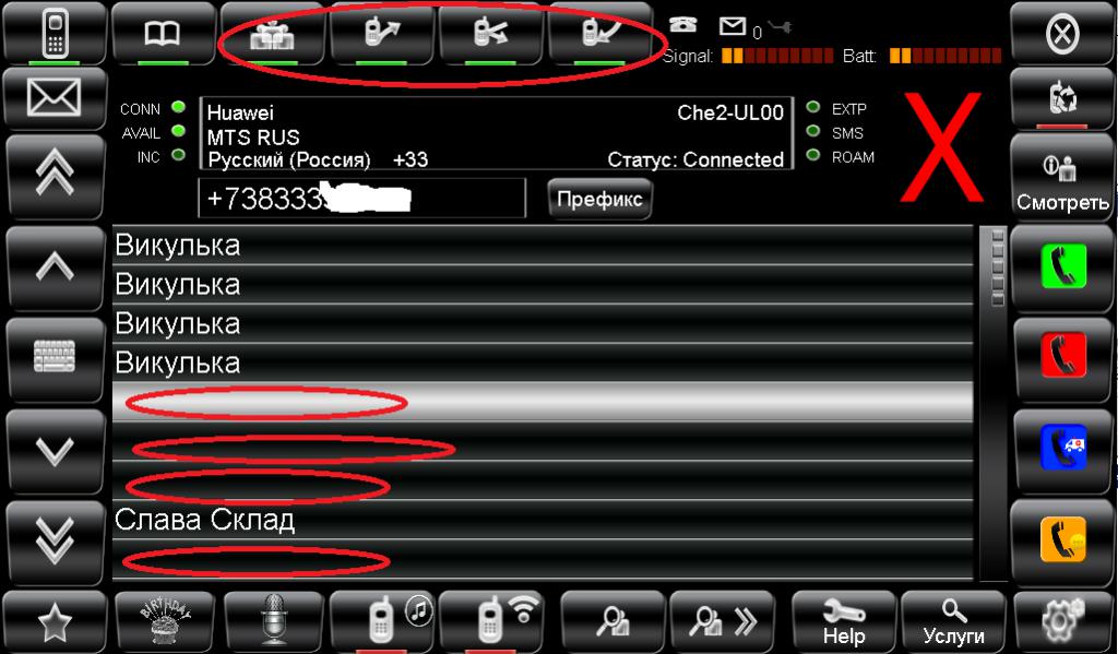

calls in, calls out, all calls ....

1.6.4.e
multi number caller not work properly
If you open an account with 3 numbers, then Subscriber with 2, then 3-rd number shows from the previous Subscriber.
Photo not show.
