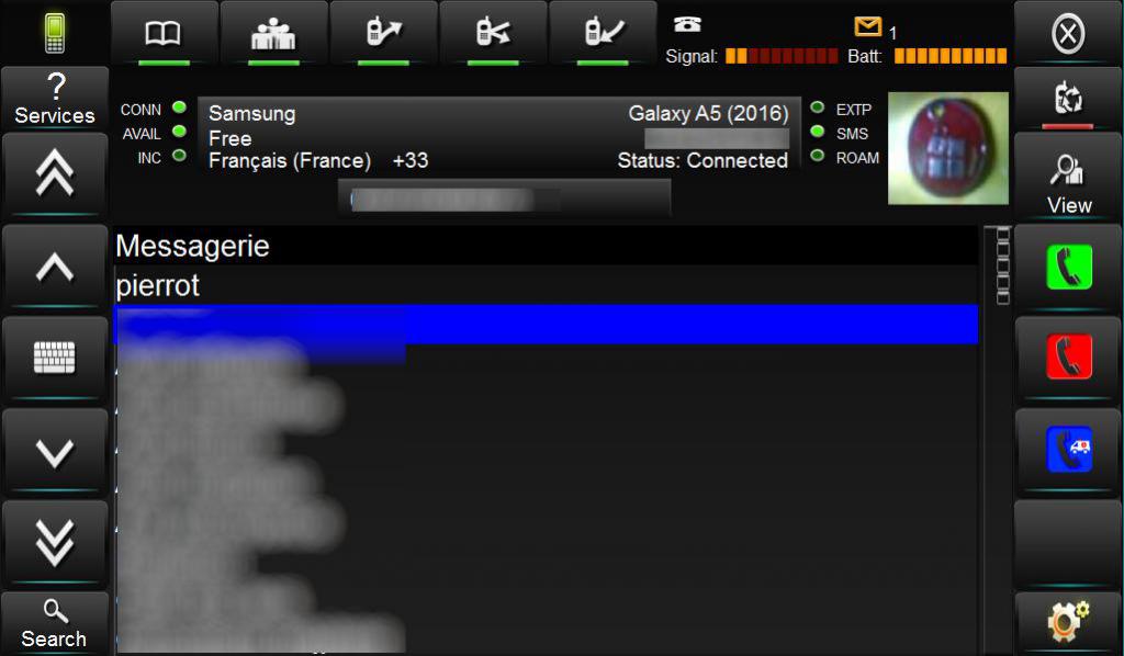

Last version v1.4.5 !
Hope you will like this new version !
