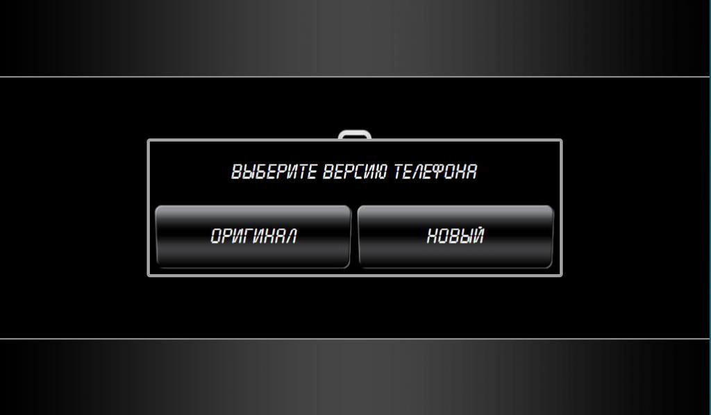

Старый 28.10.2016, 16:07   #268
pierrotm777
Аватар для pierrotm777
Регистрация: 07.11.2010
Сообщений: 324
Smile
Winlin,
Phone selector multi language !
It's ok like that ?
Старый 28.10.2016, 16:11   #269
Winlin
Регистрация: 19.11.2009
Сообщений: 308
Winlin is on a distinguished road
do not need this option. Once I put your plugin, why should I choose something again. Delete this query.
HONDA CR-V все сделано в 1.5 Din корпусе
MSI H61I-E35/Pentium G2030T/4Gb/M4-CT128M4SSD2/8"монитор/Wi-Fi/Bluetooth/усилитель MiniQuad 4х50 + конвертер SPDIF>аналог/m2-atx/HD RADIO DMHD1000I/Logitech QuickCam Pro 9000...Win7 prof
Winlin вне форума   Ответить с цитированием

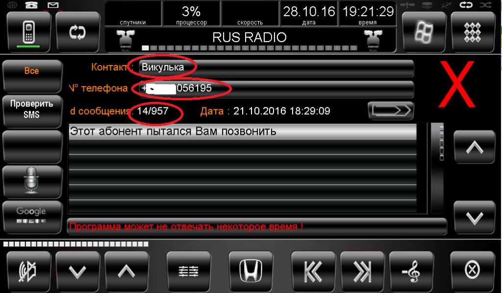

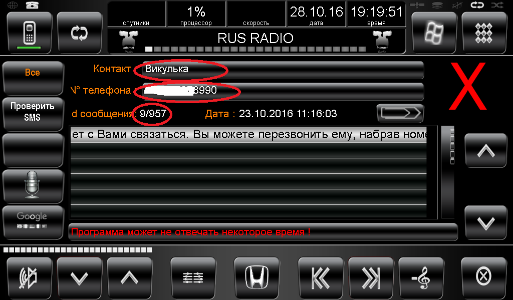

Старый 28.10.2016, 16:46   #270
Winlin
Сообщений: 308
Сообщение от pierrotm777 Посмотреть сообщение
Hummm, i have not this issue !
Can you send a picture ?
found the first caller from phone book
then comes the sms from the Subscriber not found in the phone book, but the field "contact" does not change.
now again the Subscriber from the phonebook, the field "contact" has changed and will be until there is a caller from phone book.
