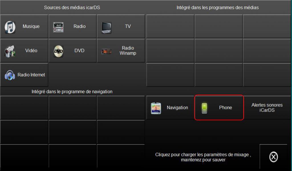

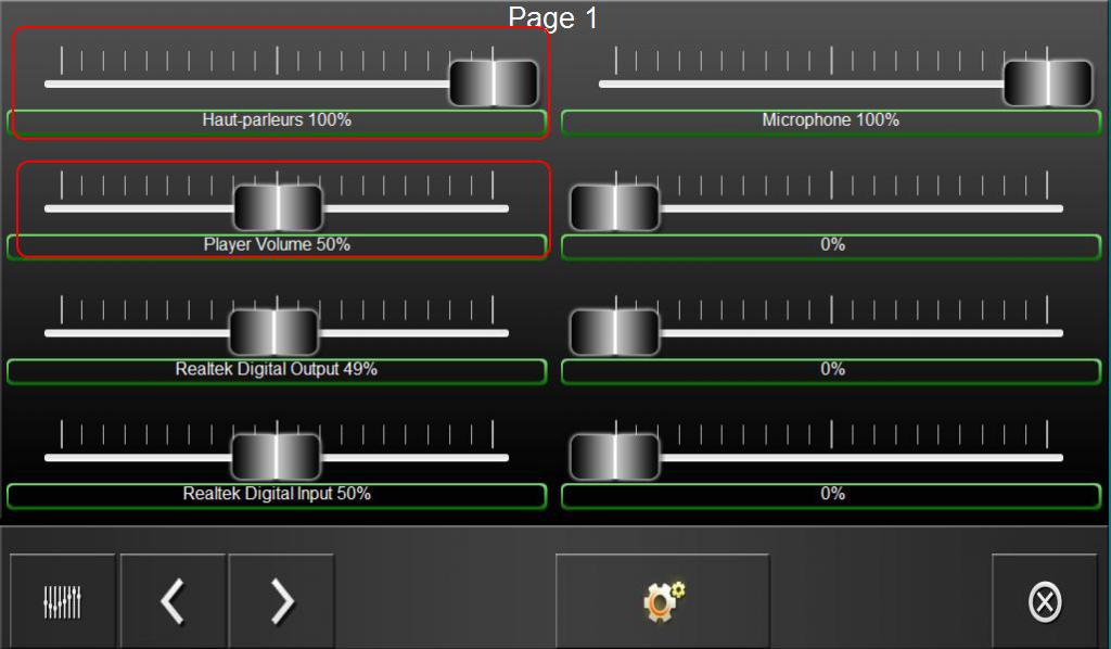

I think have found how to solve the sound issue with the phone !
Go to the mixer settings and click on the phone button (picture 1) .
Use the sliders players and main volume (picture 2).
Return to the mixer settings and hold on the phone button (picture 1) .
The phone profile now exist and is used by the commands :
Код:
"StartPhoneCall","SetVar;IsPhoneTalk;1||ByVar;IsPausedMedia;<<CF_Pause||SaveMixerPreset_Media||LoadMixerPreset;Phone||volperc+;$vol_from_speed_full$"
"EndPhoneCall","SaveMixerPreset_Phone||LoadMixerPreset_Media||ByVar;IsPausedMedia;<<CF_Resume||SetVar;IsPhoneTalk;0"
ID:	45166   Нажмите на изображение для увеличения
