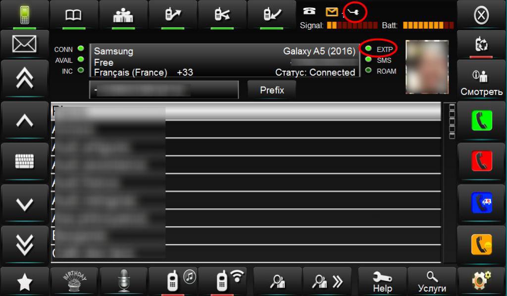

I have found a method for check if the phone is connected to an external power and run very well !
This feature will be added to the version 1.6.0 .
