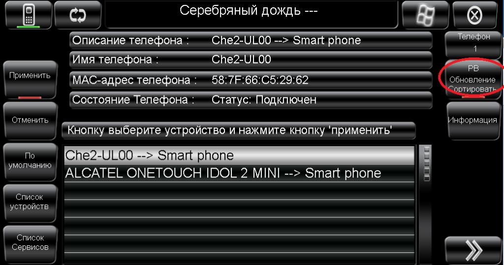

Вложений: 1
эта кнопка работает не правильно
This button does not work correctly
Вложение 45396

pierrotm777 02.11.2016 16:55
Сообщение от Winlin (Сообщение 373367)
Вложение 45396
It's exactly the same button as the MOBILEPHONE screen!
Click the button extract vcards!
Hold the button sort the main vcard list !
I it used only if a phone is already connected !

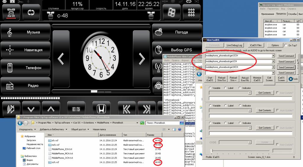

Вложений: 1
Вложение 45504
mobilephone_mch Loads the MobilePhone_MCH.txt file into the custom list
needed commands to generate a file MobilePhone_MCH.txt , MobilePhone_OCH.txt, MobilePhone_ICH.txt
pierrotm777 14.11.2016 13:44
Use the command mobilephone_phonebookget;MCH or OCH or ICH or CCH or PB
Winlin 14.11.2016 13:59
reads a phone book and makes the file mch.vcf
but not the list of missed calls
pierrotm777 14.11.2016 15:11
Сообщение от Winlin (Сообщение 374272)
I am sorry, but the mobilephone_phonebookget;MCH command build the .vcf file AND also the list file MobilePhone_MCH.txt
pierrotm777 14.11.2016 15:17
Вложений: 1
Look at that:
Winlin 14.11.2016 15:26
the contents of the files MCH.vcf AND MobilePhone_MCH.txt phone book , but not the list of missed calls
pierrotm777 14.11.2016 19:04
Сообщение от Winlin (Сообщение 374282)
You will find these files into the PhoneBook directory !
For reload these files, you must to use the command:
Код:
CLCLEAR;ALL||CLLOAD;C:\Program Files\TipTop software\iCar DS\Extentions\MobilePhone\PhoneBook\MobilePhone_MCH.txt
Winlin 14.11.2016 19:14
When you run the command mobilephone_phonebookget; MCH get files MCH.vcf AND MobilePhone_MCH.txt
but files contain phonebook, rather than a list of missed calls
When you run the command mobilephone_phonebookget;XX only changes the name of the files and the contents of the always phonebook
pierrotm777 14.11.2016 19:18
Сообщение от Winlin (Сообщение 374308)
MCH files are well the missed calls !
What do you want ! I don't understand , sorry !
pierrotm777 14.11.2016 19:21
Hoo, the MCH file return the main phonebook and not the missed calls ?
Winlin 14.11.2016 19:23
Вложений: 1
Сообщение от pierrotm777 (Сообщение 374309)
I want to take it from a phone list of missed calls
but
Вложение 45506
Winlin 14.11.2016 19:32
Сообщение от pierrotm777 (Сообщение 374312)
Yes!!!
Krysanov 14.11.2016 19:39
