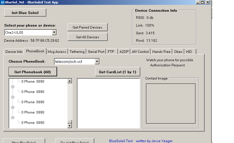

Старый 14.11.2016, 13:31   #388
Winlin
Регистрация: 19.11.2009
Сообщений: 308
Winlin is on a distinguished road
mobilephone_mch Loads the MobilePhone_MCH.txt file into the custom list
needed commands to generate a file MobilePhone_MCH.txt , MobilePhone_OCH.txt, MobilePhone_ICH.txt

Use the command mobilephone_phonebookget;MCH or OCH or ICH or CCH or PB
Старый 14.11.2016, 13:59   #390
Winlin
Сообщений: 308
reads a phone book and makes the file mch.vcf
but not the list of missed calls
HONDA CR-V все сделано в 1.5 Din корпусе
MSI H61I-E35/Pentium G2030T/4Gb/M4-CT128M4SSD2/8"монитор/Wi-Fi/Bluetooth/усилитель MiniQuad 4х50 + конвертер SPDIF>аналог/m2-atx/HD RADIO DMHD1000I/Logitech QuickCam Pro 9000...Win7 prof
