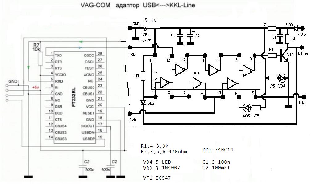

hamed-pc Here is schematic for you

Сообщений: 14
hamed-pc is on a distinguished road
Сообщение от ayra66 Посмотреть сообщение
OH My God
Very Very Thank you My Friend
I did not think. After this period, Answer me.
Are you Sure Work this schematic on my Care ?

hamed-pc,I have tested this device on KIA Sportege 1997,and I hope that it will work on your car too.
Install TECU2,Install drivers for FTDI 232 and try to conect to your car with Hundai protocol.
Hi
Thank you . ok i try Build this schematic and test on my Care with TECU2 . But . TECU2 Language is Russian . Do you Have TECU2 English Version?
Also i have Hi scan pro Cascade software . This software included Exactly My Care model Kia pride . MyBe this work With you'r schematic . I try Test to
on you'r Care K line Volt is 0V ? ُSimilar my Care?
Also i think you'r Care is obd2 . But i thinks my Care Not obd2 . May Be obd1.
what do you think?
