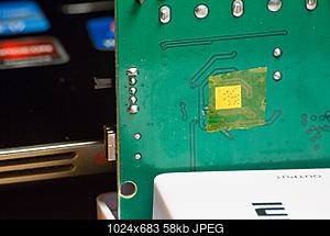

Техническая информация
HDMI2AV Converter. Реализован на чипах Chrontel CH7107A (HDMI -> CVBS + IIS/S/PDIF) + Cirrus Logic CS4344 (IIS -> 2ch audio)
http://www.chrontel.com/media/Datash...t%20Rev0.4.pdf
http://www.cirrus.com/cn/pubs/proDat...4-45-48_F2.pdf
Характеристики чипа
HDMI Receiver compliant with HDMI 1.4 specification
Support CVBS output in format of NTSC or PAL
On-chip Audio encoder which support 2 channel IIS/S/PDIF audio output
MCU embedded to handle the control logic
Support device boot up by automatically loading firmware from on-chip flash
Integrated EDID Buffer
TV connection detection supported
HDMI input detection supported
Support Auto Power Saving mode and low stand-by current
Support RGB to YCC conversion in ITU-R BT.601 and 709 color space
IIC slave interface and HDMI DDC interface are available for debug and firmware update.
Фото. Обратите внимание, селектор NTSC/PAL распаян, но дорожек к нему нет. Даже в среднем слое.
