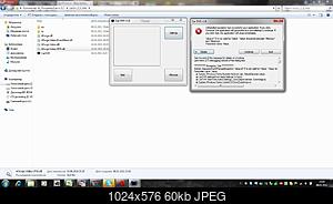

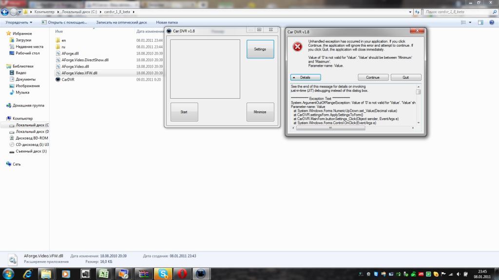

Сообщение от dues Посмотреть сообщение
тогда держи
не пускает в сеттинги, ошибка.
Дома 7ка, мож в ней проблемма ? завтра на ХР в машине проверю .
полный текст :
See the end of this message for details on invoking
just-in-time (JIT) debugging instead of this dialog box.
************** Exception Text **************
System.ArgumentOutOfRangeException: Value of '0' is not valid for 'Value'. 'Value' should be between 'Minimum' and 'Maximum'.
Parameter name: Value
at System.Windows.Forms.NumericUpDown.set_Value(Decim al value)
at CarDVR.settingsForm.ApplySettingsToForm()
at CarDVR.MainForm.buttonSettings_Click(Object sender, EventArgs e)
at System.Windows.Forms.Control.OnClick(EventArgs e)
at System.Windows.Forms.Button.OnClick(EventArgs e)
at System.Windows.Forms.Button.OnMouseUp(MouseEventAr gs mevent)
at System.Windows.Forms.Control.WmMouseUp(Message& m, MouseButtons button, Int32 clicks)
at System.Windows.Forms.Control.WndProc(Message& m)
at System.Windows.Forms.ButtonBase.WndProc(Message& m)
at System.Windows.Forms.Button.WndProc(Message& m)
at System.Windows.Forms.Control.ControlNativeWindow.O nMessage(Message& m)
at System.Windows.Forms.Control.ControlNativeWindow.W ndProc(Message& m)
at System.Windows.Forms.NativeWindow.Callback(IntPtr hWnd, Int32 msg, IntPtr wparam, IntPtr lparam)
************** Loaded Assemblies **************
mscorlib
Assembly Version: 2.0.0.0
Win32 Version: 2.0.50727.4952 (win7RTMGDR.050727-4900)
CodeBase: file:///C:/Windows/Microsoft.NET/Framework/v2.0.50727/mscorlib.dll
CarDVR
Assembly Version: 1.8.0.0
Win32 Version: 1.8.0.0
CodeBase: file:///C:/cardvr_1_8_beta/CarDVR.exe
System
Win32 Version: 2.0.50727.4927 (NetFXspW7.050727-4900)
CodeBase: file:///C:/Windows/assembly/GAC_MSIL/System/2.0.0.0__b77a5c561934e089/System.dll
CodeBase: file:///C:/Windows/assembly/GAC_MSIL/System.Windows.Forms/2.0.0.0__b77a5c561934e089/System.Windows.Forms.dll
System.Drawing
CodeBase: file:///C:/Windows/assembly/GAC_MSIL/System.Drawing/2.0.0.0__b03f5f7f11d50a3a/System.Drawing.dll
CarDVR.resources
CodeBase: file:///C:/cardvr_1_8_beta/en/CarDVR.resources.DLL
AForge.Video.VFW
Assembly Version: 2.1.3.0
Win32 Version: 2.1.3.0
CodeBase: file:///C:/cardvr_1_8_beta/AForge.Video.VFW.DLL
AForge.Video.DirectShow
CodeBase: file:///C:/cardvr_1_8_beta/AForge.Video.DirectShow.DLL
AForge.Video
CodeBase: file:///C:/cardvr_1_8_beta/AForge.Video.DLL
************** JIT Debugging **************
To enable just-in-time (JIT) debugging, the .config file for this
application or computer (machine.config) must have the
jitDebugging value set in the system.windows.forms section.
The application must also be compiled with debugging
enabled.
For example:
<configuration>
<system.windows.forms jitDebugging="true" />
</configuration>
When JIT debugging is enabled, any unhandled exception
will be sent to the JIT debugger registered on the computer
rather than be handled by this dialog box.

Сообщение от bother Посмотреть сообщение
Исправил
Тип файла: zip cardvr_1_8_beta2.zip (183.2 Кб, 911 просмотров)

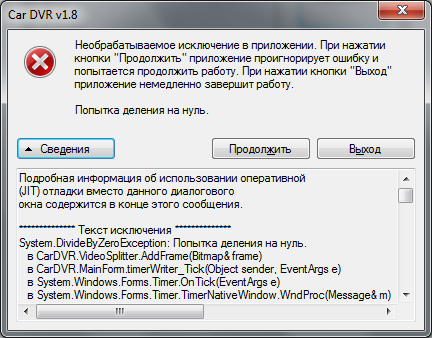

А у меня на семерке вот такая ошибка вылетает:
этого сообщения.
************** Текст исключения **************
System.DivideByZeroException: Попытка деления на нуль.
в CarDVR.VideoSplitter.AddFrame(Bitmap& frame)
в CarDVR.MainForm.timerWriter_Tick(Object sender, EventArgs e)
в System.Windows.Forms.Timer.OnTick(EventArgs e)
в System.Windows.Forms.Timer.TimerNativeWindow.WndPr oc(Message& m)
в System.Windows.Forms.NativeWindow.Callback(IntPtr hWnd, Int32 msg, IntPtr wparam, IntPtr lparam)
************** Загруженные сборки **************
mscorlib
Версия сборки: 2.0.0.0
Версия Win32: 2.0.50727.5018 (Win7RTMLDR.050727-5000)
CarDVR
Версия сборки: 1.8.0.0
Версия Win32: 1.8.0.0
CodeBase: file:///C:/cardvr_1_8_beta2/CarDVR.exe
System
Версия Win32: 2.0.50727.5000 (Win7RTMLDR.050727-5000)
Версия Win32: 2.0.50727.4927 (NetFXspW7.050727-4900)
System.Drawing
CarDVR.resources
CodeBase: file:///C:/cardvr_1_8_beta2/ru/CarDVR.resources.DLL
AForge.Video.VFW
Версия сборки: 2.1.3.0
Версия Win32: 2.1.3.0
CodeBase: file:///C:/cardvr_1_8_beta2/AForge.Video.VFW.DLL
CodeBase: file:///C:/cardvr_1_8_beta2/AForge.Video.DirectShow.DLL
AForge.Video
CodeBase: file:///C:/cardvr_1_8_beta2/AForge.Video.DLL
mscorlib.resources
System.Windows.Forms.resources
CodeBase: file:///C:/Windows/assembly/GAC_MSIL/System.Windows.Forms.resources/2.0.0.0_ru_b77a5c561934e089/System.Windows.Forms.resources.dll
************** Оперативная отладка (JIT) **************
Для подключения оперативной (JIT) отладки файл .config данного
приложения или компьютера (machine.config) должен иметь
значение jitDebugging, установленное в секции system.windows.forms.
Приложение также должно быть скомпилировано с включенной
отладкой.
Например:
<configuration>
</configuration>
При включенной отладке JIT любое необрабатываемое исключение
пересылается отладчику JIT, зарегистрированному на данном компьютере,
вместо того чтобы обрабатываться данным диалоговым окном.
проверь, у тебя в настройках длительность видео-файла не 0 минут случайно ? если в программу зайти не можешь, в реестре HKEY_CURRENT_USER\Software\CarDVR меняй параметр AviDuration
dues вне форума   Ответить с цитированием
Старый 09.01.2011, 14:04   #68
lti1
Аватар для lti1
Регистрация: 17.01.2010
Город: Самара
Сообщений: 457

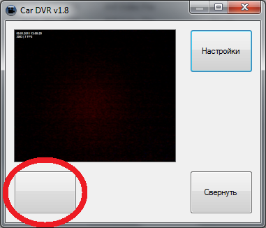

Так и есть, спасибо!
А еще с русской локализацией не прописана кнопка "СТОП".
Название: Car DVR v1.8.png
