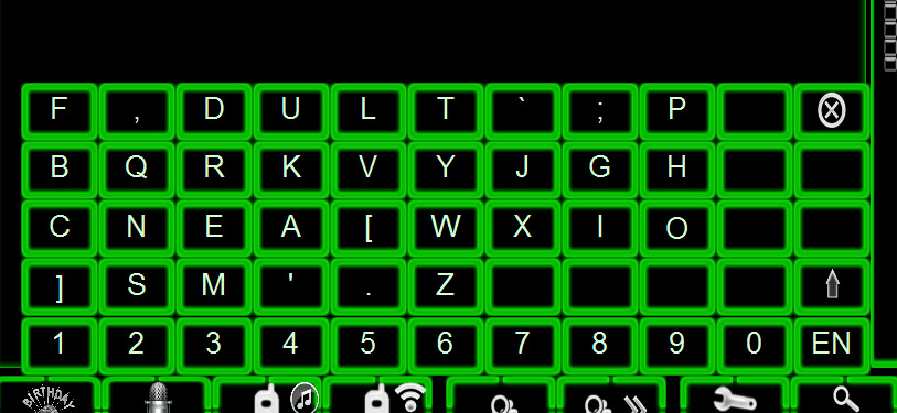

the sound is set to maximum
Yes, and have already wrote.
Uninstall issue is solved !
Where , Version 1.5.7 ?
For me , the keyboard is ready
NO work to switch RU-ENG
but Works ENG-RU
Wrong characters displayed now the English keyboard :

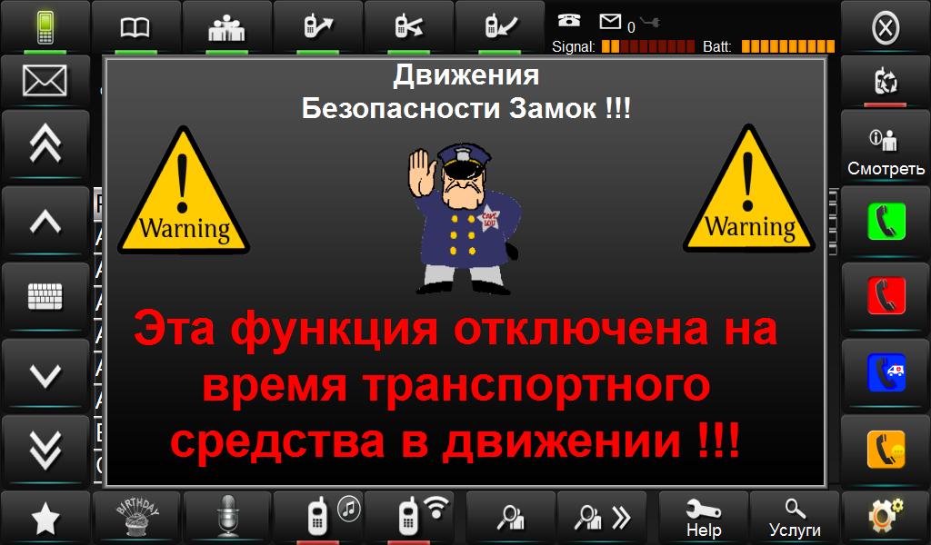

The version 1.6.0 will introduce the 'Lock in Motion' feature completely functional !
If this feature is set to true in settings, the SMS access (read or write) will not possible if the car's speed is > 0 km/h .
