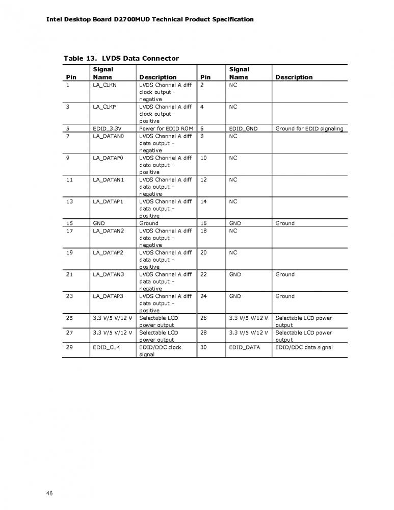

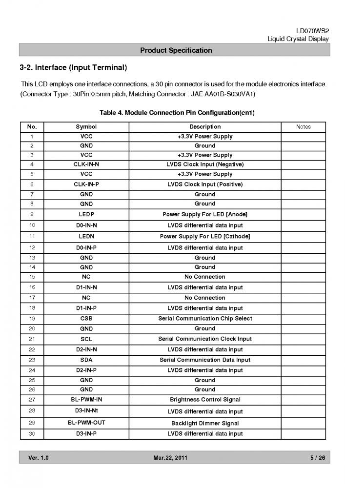

1) VCC + 3.3V Power Supply
- 25) 3.3 V/5 V/12 V Selectable LCD power output
2) GND Ground
- 15) GND Ground
3) VCC +3.3V Power Supply
- 26) 3.3 V/5 V/12 V Selectable LCD power output
4) CLK-IN-N LVDS Clock Input (Negative)
- 1) LA_CLKN LVDS Channel A diff clock output - negative
5) VCC +3.3V Power Supply
- 27) 3.3 V/5 V/12 V Selectable LCD power output
6) CLK-IN-P LVDS Clock Input (Positive)
- 3) LA_CLKP LVDS Channel A diff clock output - positive
7) GND Ground
- 16) GND Ground
8) GND Ground
- 22) GND Ground
9) LEDP Power Supply For LED [Anode]
10) D0-IN-N LVDS differential data input
- 7) LA_DATAN0 LVDS Channel A diff data output – negative
11) LEDN Power Supply For LED [Cathode]
12) D0-IN-P LVDS differential data input
- 9) LA_DATAP0 LVDS Channel A diff data output – positive
13) GND Ground
- 24) GND Ground
14) GND Ground
- 24) GND Ground
15) NC
16) D1-IN-N LVDS differential data input
- 11) LA_DATAN1 LVDS Channel A diff data output – negative
17) NC
18) D1-IN-P LVDS differential data input
- 13) LA_DATAP1 LVDS Channel A diff data output – positive
19) CSB Serial Communication Chip Select
20) GND Ground
- 24) GND Ground
21) SCL Serial Communication Clock Input
22) D2-IN-N LVDS differential data input
- 17) LA_DATAN2 LVDS Channel A diff data output – negative
23) SDA Serial Communication Data Input
24) D2-IN-P LVDS differential data input
- 19) LA_DATAP2 LVDS Channel A diff data output – positive
25) GND Ground
- 24) GND Ground
26) GND Ground
- 24) GND Ground
27) BL-PWM-IN Brightness Control Signal
28) D3-IN-Nt LVDS differential data input
- 21) LA_DATAN3 LVDS Channel A diff data output – negative
29) BL-PWM-OUT Backlight Dimmer Signal
30) D3-IN-P LVDS differential data input
- 23) LA_DATAP3 LVDS Channel A diff data output – positive
Правильно ли я сопоставил контакты?

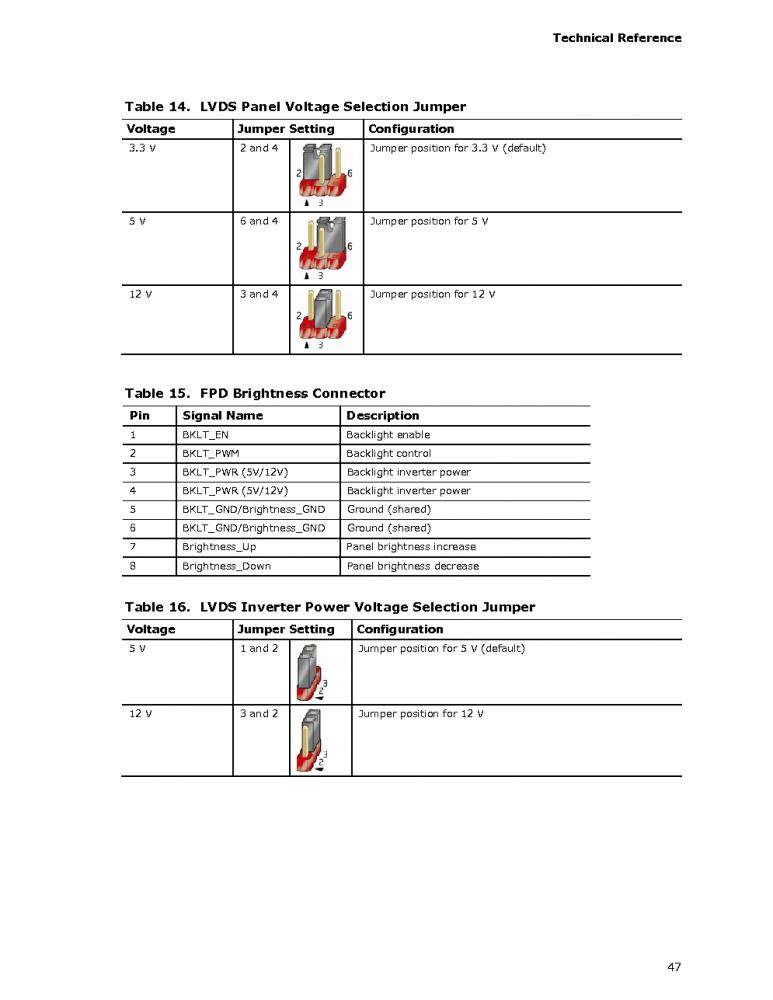

Для чего нужен FPD Brightness Connector (3 фото)?

LVDS Inverter Power Voltage Selection Jumper -джампер выбора питания на инвертер лампы
Если непутаю то
27) BL-PWM-IN Brightness Control Signal -сигнал включения подсветки
29) BL-PWM-OUT Backlight Dimmer Signal -сигнал регулировки яркости подсветки

из FPD Brightness Connector 2) BKLT_PWM backlight control
сюда 27) BL-PWM-IN Brightness Control Signal нужно подключить?
а в 29) BL-PWM-OUT Backlight Dimmer Signal что нужно?
